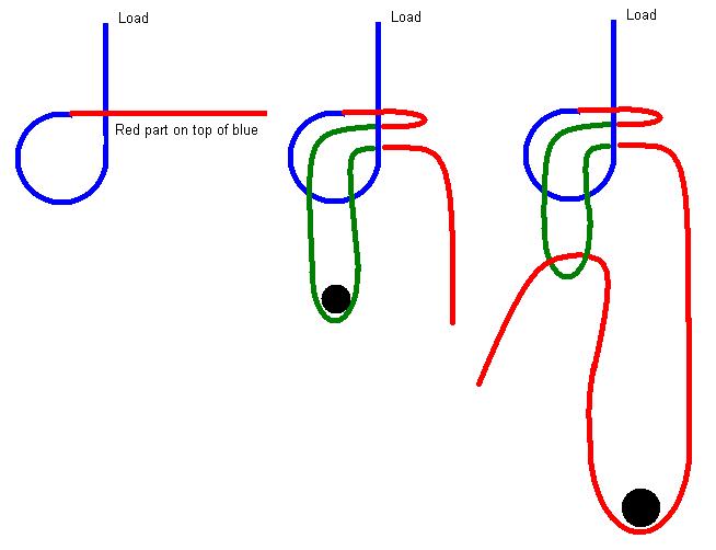

LandyManLuke Posted April 3, 2007 Posted April 3, 2007 There's a knot which i use all the time. Ok, it's slightly harder to undo, but it's a damn sight easier to tie!!! tie a slipped over-hand knot, with the standing part going away over the load, and the working end forming the loop to the tie-down. You'll be able to sweat this down plenty. form a bight in the standing (blue) part of the rope, so the working end (red) is on top. take this behind the standing part and pull a bight through the loop (green). either hook the loop over the tie down, and sweat it down, or preferably, use it to feed the working end (red) back through after passing it through a rail, hole etc. I always do it the second way, as it's easier to work with. Quote
MogLite Posted April 3, 2007 Author Posted April 3, 2007 Great feedback - thanks. The truckers hitch does look damn complicated. I'll give LandyManLuke's a go though - I might just be able to manange that Quote
Gromit Posted April 3, 2007 Posted April 3, 2007 I use ratchet straps for most things. Kayaks mostly. I find that you need to put a locking hitch against the cam so stop it slipping after a while. When tying down with ropes, make sure your ropes are good enough that they won't work loose. Climbing rope is great, that blue nylon stuff is terrible. Truckers hitch as per LandyManLuke every time. The free end then gets rolled around the rack a few times with a few hitches (bit like a clove hitch?) for extra security. Watch ropes and straps in the rain as they tend to work loose more. Quote
LandyManLuke Posted April 3, 2007 Posted April 3, 2007 Climbing rope is great, that blue nylon stuff is terrible. Amen to that!! I usually either finish with a clove hitch round a roof rack rail, or a rolling hitch around the working parts that've just been sweated down. This holds incredibly well. You can repeat the loops for extra purchase, though after about 3 loops, friction becomes more of a problem. Quote
